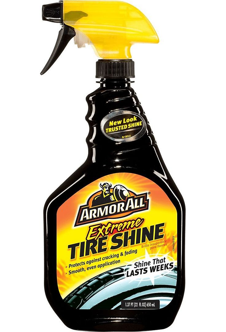

To make this thread complete, for the OE wheels that you Plasti Dipped (the wheels you've used on cross-country trips), what recommendations/products have you used for cleaning and preserving the Plasti Dip?
Pretty simple, i just wash with a rinseless and wipe down with Armour all extreme tire shine....works well. I did a search of the detailing sites and that's what people were using on the plastidip. PD makes their own detailer/topper but I did not find it to work as well as the tire shine. Spray the applicator, not the wheel.
