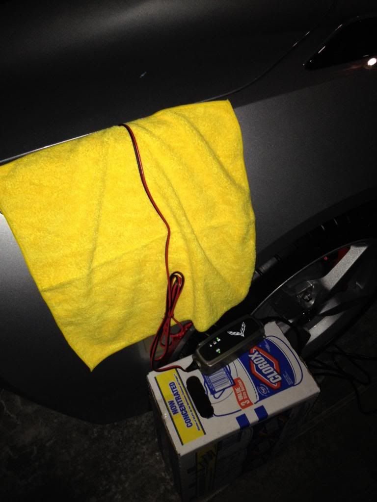

In keeping with relentlessly beating a dead horse: All "trickle charges" are not created equal. And no, the $5 wonder at the local discount store is NOT "just" as good as a quality charger. In fact, a junk charger can cause more harm than good. And...just because the car starts after a prolonged period of time without charging does not mean the battery has survived just fine. Leaving a battery connected without a trickle charger is about the worst thing to do to a battery. Disconnected without a charger for months is not the worst thing in the world. Lastly, "more amps" is not necessarily "better".
I have about 8 (!) Battery Minder units that maintain batteries for my boat, PWC, ATV, travel trailer, cars, snowmobiles, lawn mower, tractor... They serve me well. Battery Tender is another good brand. C-Tek (manufacturer of the Corvette Battery Protection Package") is considered pretty much top shelf. There are other good units I'm sure. But, they all cost more than $5!
I'd get that concentrated bleach away from my Corvette. Ha Ha.
