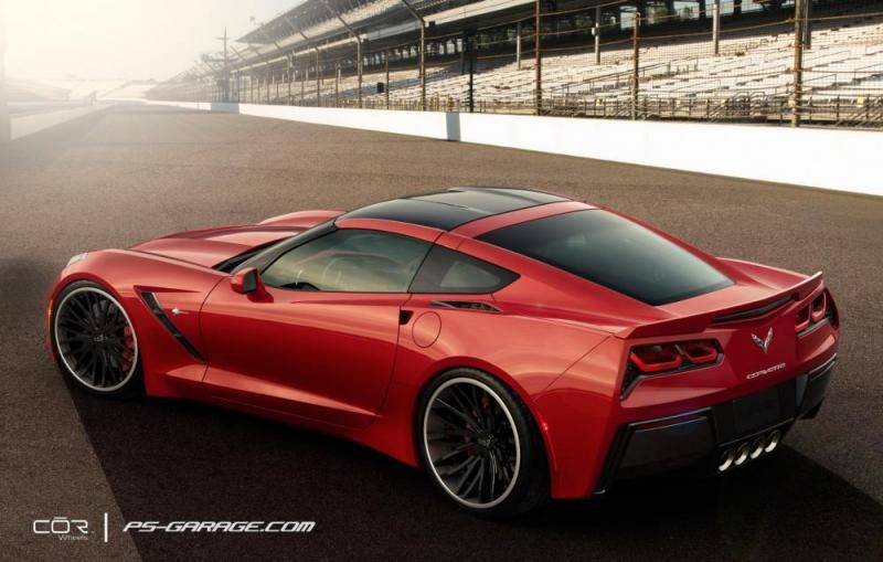

You might have already noticed... but I LOVE wheels. :) I have a set in the works that just came out and they're from a place that mostly does exotics. In my search, I've collected as many pics as possible as well as some renderings too. I thought I'd share what I have with you guys in the event it might help anyone looking. Feel free to add whatever you find as well! Anyone looking for wheels, I'll do whatever I can to help. Most can do a x10 front and a x12 rear but it's pushing it, x9.5 and x11.5 are "safer" really to ensure no rub because all tires are not true to their numbers. 305 Michelin Supersports are wider than Michelin PS2s which are wider than Bridgestons for example.
One of my FAVORITES! Forgeline
COR on a weapon X motorsports sponsorted C7 that we'll be doing another project on next month:
