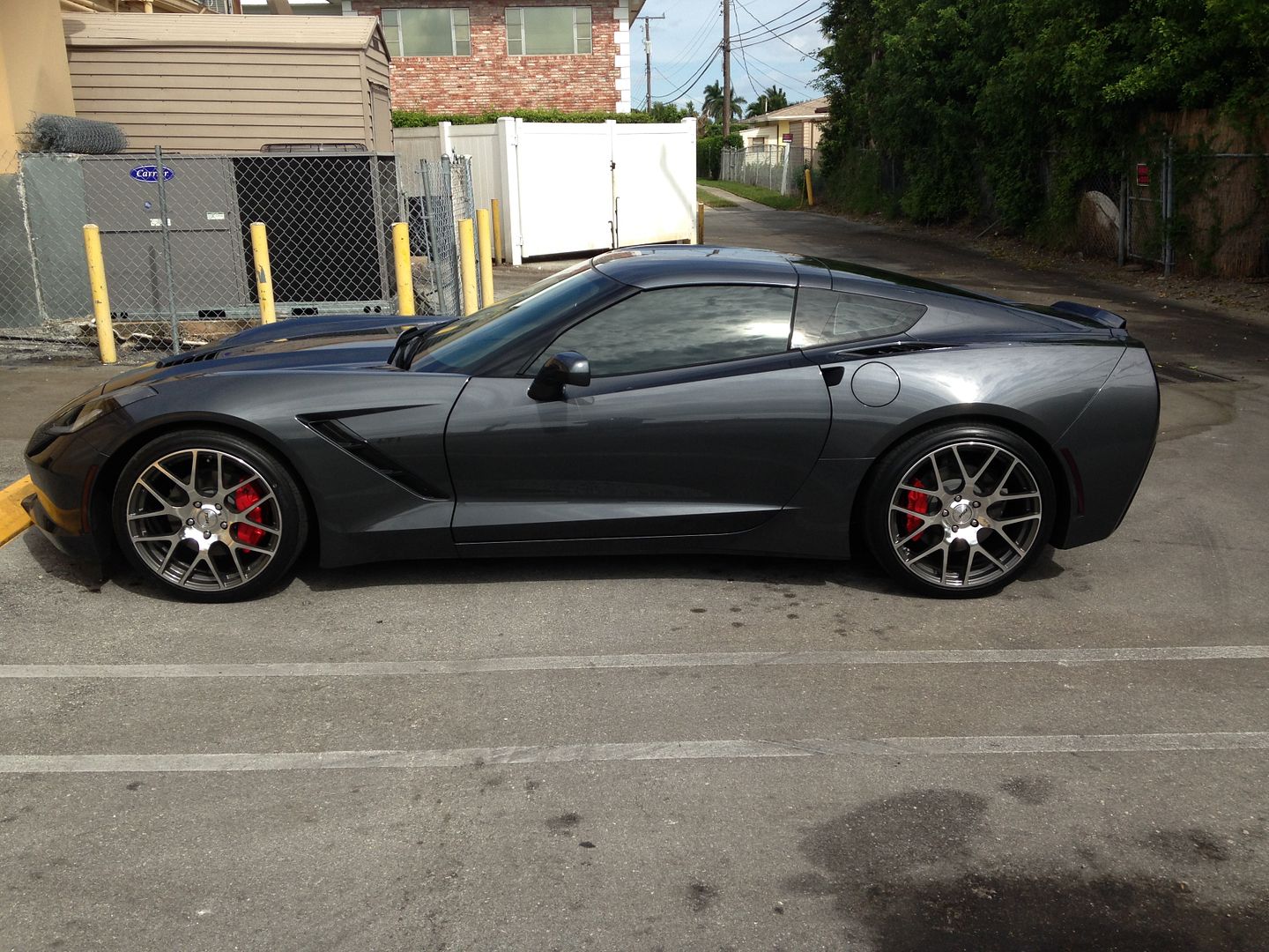

Mod 1:TSW Nurburgrings
Ok The "fake forged" (inside joke)...are going on, check back for updates. A few bits of info: no centering rings, offset perfect, TPMS monitors switched, no problem. The contrast paint on wheel matches EXACTLY the cyber gray...
Here are the specs on the wheels to buy....tires are same size as z51;
front
NURBURGRING 19x9.0 5/120.65 ET50 GUNMETAL W/MIRROR CUT FACE
Item Number: 1990NUR505121S70
rear
NURBURGRING 20x10.5 5/120.65 ET65 GUNMETAL W/MIRROR CUT FACE
Item Number: 2005NUR655121S70
With new tires it's a 2500-3000 expense depending on tires

Lowering on bolts
Had the car after wheels lowered using the bolts...interesting and maybe why we are seeing diff levels coming out of factory. The rear was already lowered virtually all the way and the bolts would only go down.2 and the front took .75....had it done at Lashway mtr sports as I did not want to screw with it...he also measured each side and was $100.. Great shop owns a C7 ...Eric at Lashway mtr sports
954 971 4383

ok over speed bumps, but will scrape if pulled too far up on a parking ingot...

Each time I see your TSW Nurburgrings they grow on me. Very nice! :cool:
