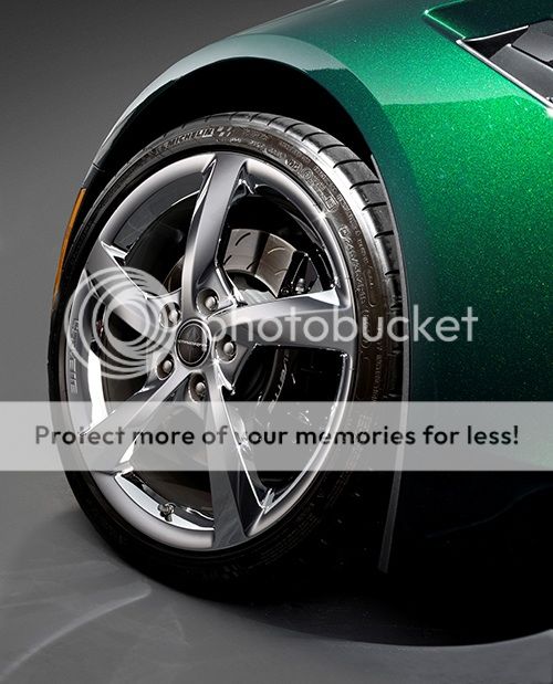

The Corvette always has been built to perform. Part of the ride and handling equation is the high-performance tires available on recent Corvettes.
The 2014 Corvette is equipped with standard P245/40ZR18 front and P285/35ZR19 rear performance summer-only tires and the Z51 Performance Package includes P245/35ZR19 front and P285/30ZR20 rear Michelin Pilot Super Sport ZP summer-only tires. (Fig. 9) These tires may have a chatter noise during low speed turns.
(Similarly), the tread design of the Goodyear F1 tires on the 2011-2013 Corvette Grand Sport and Z06 models also is more susceptible to tire chatter or hop than the tread design on previous F1 tires.
Tire chatter noise, caused by the large amount of tire scrubbing across the pavement, occurs most often during low speed, tight turns (in all directions) when the tires are cool, usually after an extensive ambient soak of the vehicle. The chatter typically diminishes when the tires warm up, but may increase on wet pavement. This is a normal characteristic of the high-performance tires.
