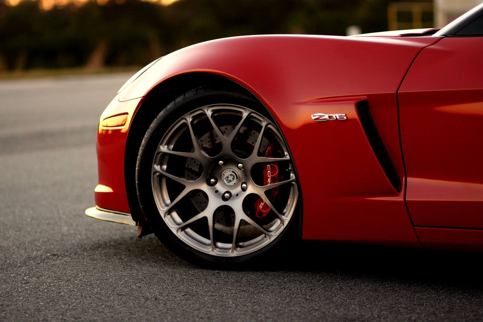

As we do not yet have a wheel and tire vendor, and in view of the huge importance for considering weight different when changing stock wheels for aftermarket, I wanted to post this one example. While the following example resulted in significantly less unsprung weight, there are wheels that look great, but weigh many pounds more than factory StingRay wheels.
"Lowered it as much as we could on the stock bolts. Installed the HRE P101's on factory Michelin Super Sports. Weighed the factory wheels and tires.
Fronts 51.5 lbs each.
Rears 60 lbs each.
Weighed the HRE's after we mounted the Michelins onto them.
Fronts 48.2 lbs each.
Rears 54 lbs each."
HRE's are super expensive, though superb quality. Here's how this one example looks:

:cool:But HRE's puts it in the super car look. There are some wheels that put the car over tbe top.
I really don't see it that way and I'm a huge "research before you buy guy"...I certainly have the money to do HRE's but just can't see putting 9K into tires and wheels for a 60K car. Primarily because of the offset and specs, you can't get a concave wheel on a Vette, acc to the HRE dealer. You will on the wide body, but for now they all look flat. And therefore I'll pay for TSW Nurburgrings vs the HRE - because from 15 feet away you can't tell, and outside the forums no one can tell (meaning normal people...LOl) and they are 19# front and 22# rear...no downsides of this application.
of course the HRE looks a bit better, but not $6k better....IMO
