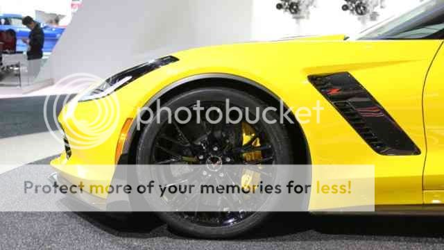

For engineers, the Z06 is all about reducing parasitic drag while increasing useful downforce to keep the trackiest Corvette glued to the road and/or track. At the front, a few things will strike you. First is just how wide this is. The Z06 is two inches wider in the front, three inches in the rear. In fact, the front fender flares have their own fender flares.
In addition, the Z07 package includes these wicked canards off the front splitter to help channel air up and over those massive flares, thereby increasing downforce. As the air runs along the side, it's channeled by the protruding carbon fiber sills, that continue to help direct the air just where it's needed.
