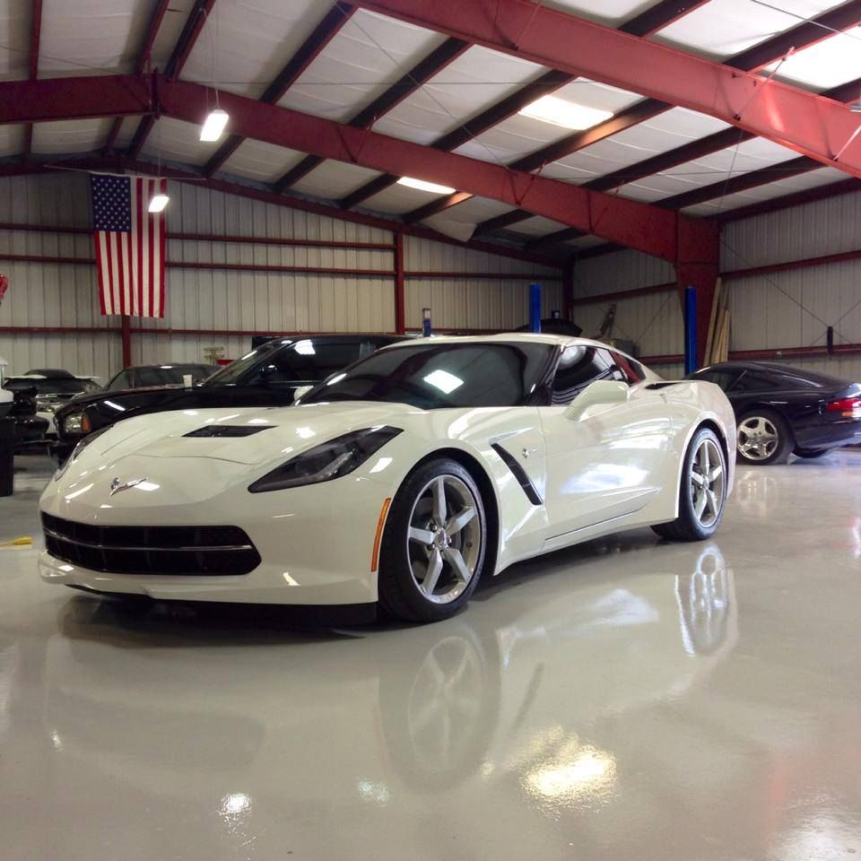

A little more about lowering, as in the following pictures of someone who has just done that. Personally, would wait a month, as new Corvettes settle on their composite springs. We have seen StingRays which almost look "jacked up," while other look like they have settled nicely. Probably, that is due to the amount of time since they left the production line, the amount of miles they have been driven since, etc. In the pictures below, they lowered the front .75" (as much as they could on stock bolts), the rear .25". Would suggest that each car be measured and its lowering be separately determined, not mimicking what was done for this white car. Also would strongly recommend an alignment afterwards.
