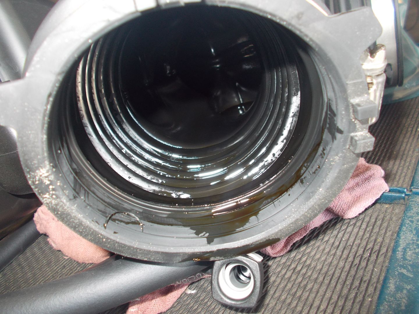

Very common with these....when you can dump oil out of the air intake assy your ingesting a ton of it and doing your motor no good:
The new Z06 has several updates that address the oil puking (burping) into the air intake bridge assy, but for you the only solution is to address it yourself by running lower on oil and installing the RX system that corrects this issue.
Lots of info here for you to read in several threads to understand it all.

daddy, Just to verify take a flat blade screwdriver and take the coupler loose from the throttle body. Reach into the air bridge with a clean paper towel and rub around to see if your still getting oil ingestion....you will be surprised.

Any that want to check to see if you have the issue (not all drip on the ground), simply remove the air bridge from the throttle body and reach into the bridge with a clean paper towel. Takes 5 minutes and very rare to see any that do not have oil saturated in the intake air bridge. Take these apart steadily and only one to date had very little (almost none) in it...and that is out of a couple dozen? Try it....just takes a flat blade screw driver.
