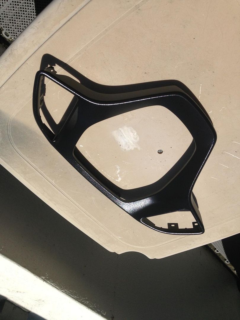

I owed John a favor and in anticipation of his Z06, he wanted a gloss black steering wheel bezel so I told him to buy the paint and the part and send it to me. It took all of an hour today to accommodate him.
So here's the steps:
1. sand lightly with 2500/3000 wet sand paper
2. wipe it w/ acetone and alcohol
3. one light dusting with rustoleum primer -wait 5 min
4. two light coats of chevy black - wait 10 min between coats, then wait 30 min
5. three coats of gloss clear - 10 min between coats
Paint at automotivetouchup.com, when you spray, move around the piece, spray in spritze's from all angles.
no sanding between any paints - and it's done. Now I will send to John and he will do 500 strokes with finishing polish, and then it'll be a Steinway piano super gloss lacquer finish!
the stock part john sent after sanding
the blackbasecoat
after 3 coats clear:

You really can overdo something like carbon fiber....I think this will look good, and by NOT making this CF, it accentuates any CF you have, like above. TOO MUCH CF makes me dizzy.....
Here's another pic after curing a few hours, very little polishing is gonna be needed:

Yeah some gift....I never painted anything until last year. Watched about 10 you tube videos, and practiced on about 5 plastic switch plates.....never done any mod easier.....

if oyu used the automotivetouchup stuff you can polish after 24 hours, I wait 48...but have done 24...it even says that on their site that 24 is ok...
3000 grit then finishing polish, like I said, 300-500 strokes or so, I usually do a little bit every day with a microfiber for 3-4 days........

Also big tip: when you spray, move around the piece, spray it from diff angles....

Nice paint job. However, my preference would be a satin black finish, as there are no other glossy surfaces in the C-7 interior that I know of. Finger prints and dust would require constant wiping.
On a bezel, it never gets fingerprints as you don't touch it (mine is gloss going on 3 months, never cleaned) but matte gloss is just another selection on the paints avail. Have at it!
