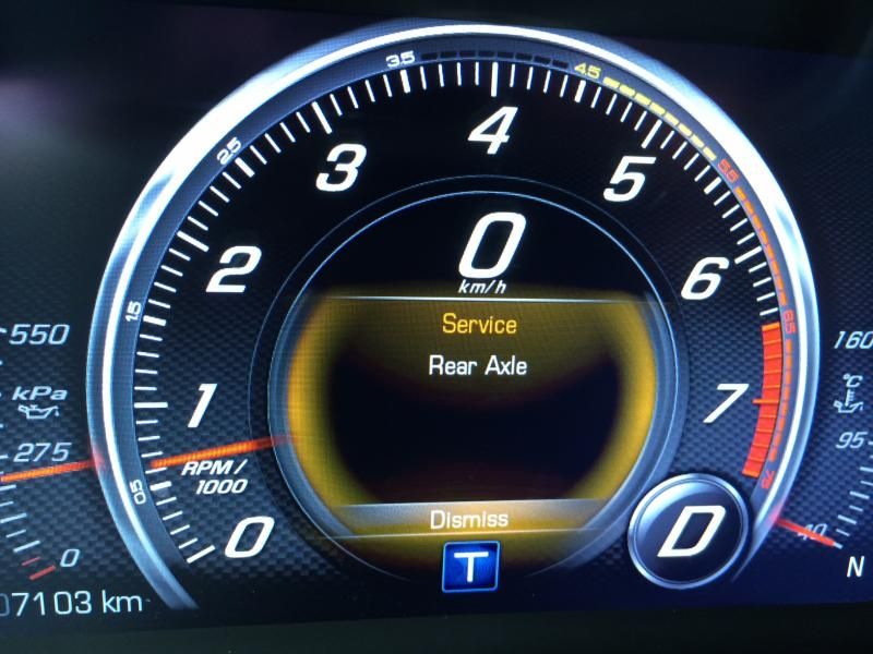

This message has popped up 3 times now within the last tank of gas. First time it came I thought perhaps it was a glitch. Do not notice any difference while driving. The car only has 4400 miles on it. 2014 Z51 with mag. Any thoughts? Hopefully this isn't something serious, I haven't had any real issues with my car so far. Thanks.

zimm888, what is your VIN and/or build date? Chip, what do you think/suggest?
This message has been seen before for the rear differential. Do take it to your dealership service department as soon as possible.

You'll be hearing from experts here soon, but quick fill-in: there are threads about factory under-filling differentials (by half). Dealers advised to check the level at 1st oil change. I don't recall mention of any damage. Problem was supposedly caught and corrected after a certain date or vin#.

not positive on my build date, the last 5 digits of my VIN are 11482. Is that right info?
Yes, that tells us that your car was built in the first 1/3 of the 2014 production year.

Did you ever have it checked for the correct rear differential fluid levels?

The message also comes up under a low voltage situation and/or defective loose battery cables at the battery.
Start with the easy stuff; Check battery voltage after a 24 hr. rest.(12.6 V. or better) Check battery terminals for tightness, if they are OK, there is a pump plug in the system that is know to become lose and create this warning. You need to get the e-diff checked for lube level and assurance that it is metal shavings free. I suggest you take it in and let your service people run it down.
http://www.stingrayforums.com/forum/stingray-corvette-tsb-recalls/2824-chevrolet-corvette-power-train-service-bulletin-361376-a.html
