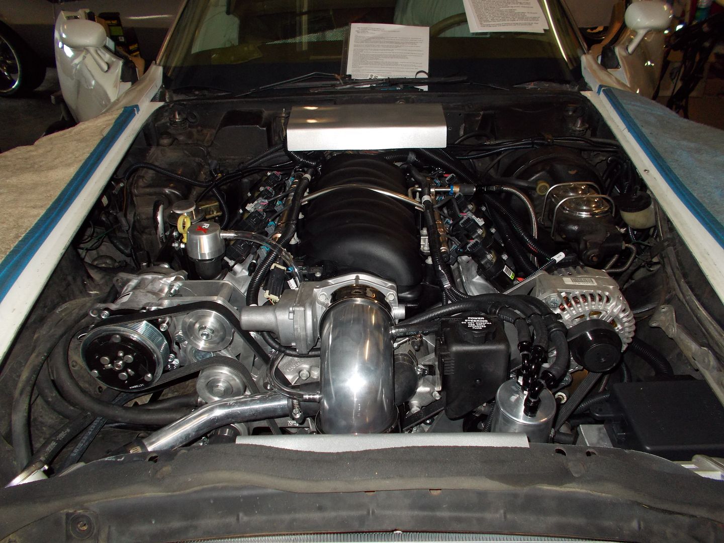

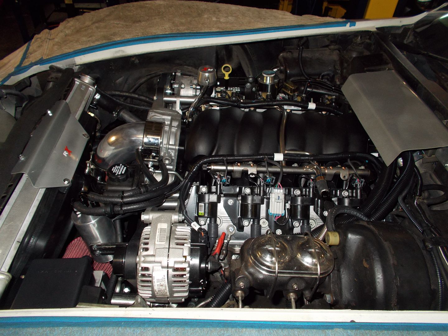

Some of the final pics. Runs great, after priming oil pump fired immediately and other than running a little rich due to a bit higher fuel pressure (VetteWorks in tank system...nice one), and a power steering line leak, thing turned out awesome! 525 hp GM Performance LS3 connect and cruise kit...really made the wiring a snap.

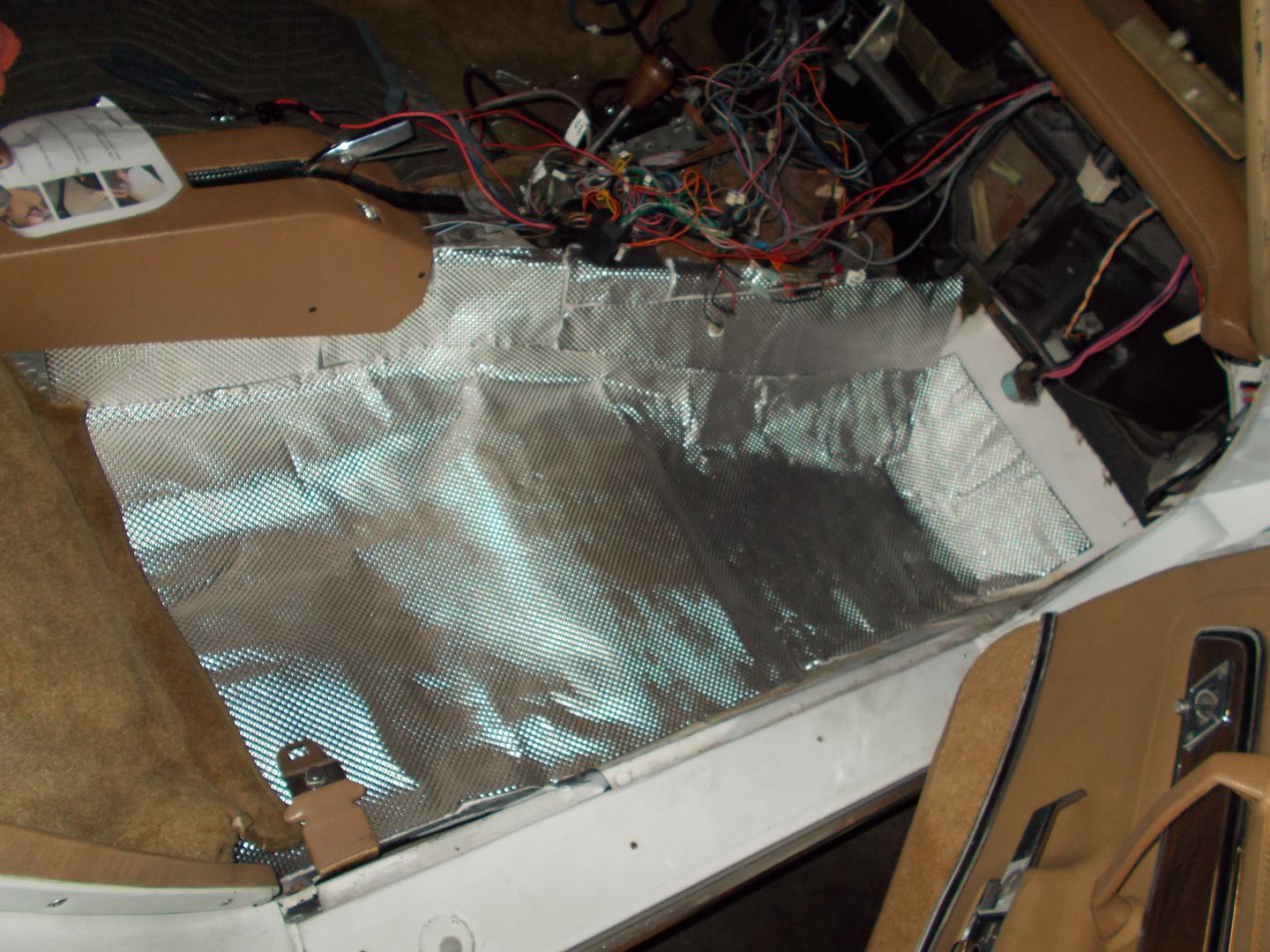

Sound and heat barrier throughout interior:
Nice, clean install and the hood fit fine:

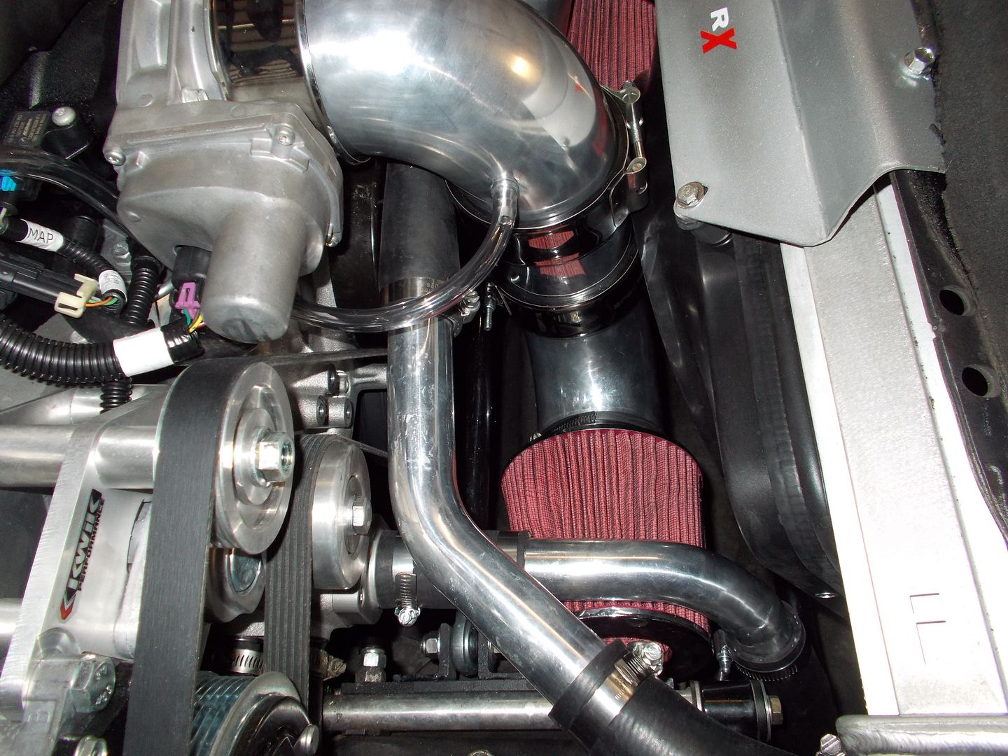

Fabbed a dual filer intake drawing from low:
Did all RX billet pulley's as well:
Did mandrel bent pipes for the radiator coolant tubes:
