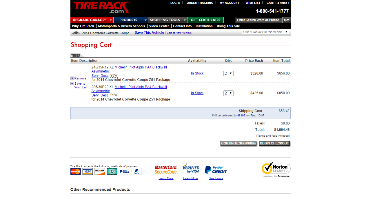

I just ordered a set of Continental ExtremeContact DWS tires in the Z51 sizes you are pricing. They do not come up if you input your Corvette, but they will come up if you search for tires in the Z51 sizes separately. Around $200 a tire for the fronts, around $253 a tire for the rears. They are all season tires, but are rated very highly for snow use.

thanks for the tip....price sure is better!

If you like Michelins, don't forget that Costco sells them. You get a great installed price and a good warranty. I did this for Pilot Sports on my 95 ZR-1. --Bob

Rob, Thanks for the info on those tires, I need to find some for NC winter driving similar to what Racer X is talking about. I've always had good luck with Conti's over the many years.

Well, I bit the bullet today and ordered the Michelin Pilot Alpin PA4s for my Z51 coupe through a local auto repair shop that I have dealt with in the past. Total price installed is almost $1800. I'm not too concerned with whether I could have saved a hundred bucks by going someplace else as he will store the summer tires for me over the winter and has the equipment to mount the tires without damaging the wheels. My hope is that I will get a second set of wheels for the Stingray in spring once more aftermarket options are available.
I'll keep you all posted on how they perform once I get some miles on them. I do know that I have experienced that the summer tires loose a lot of grip and the front hops a lot more when the temp is in the 30s. I do intend to drive the car year round up here in Wisconsin.

I'm willing to try these this winter, but this price is almost a deal breaker.:ack: I'd like to get it closer to $1300 or less...anyone have another source at a better price?
I got a quote from Sam's Club for Michelin Pilot Sport A/S 3's to fit a Z51, 45,000 mile warranty, Front $249 and Rear $310.27 for a total of $1270 installed.

FYI...due to the staggered size and inability to rotate, the 45K mile warranty is substantially reduced. I think you only get 50%...
I've got A/S 3's on my Infiniti. Not the best stick in hot or cold weather. A/S 2's were better, but more expensive.
