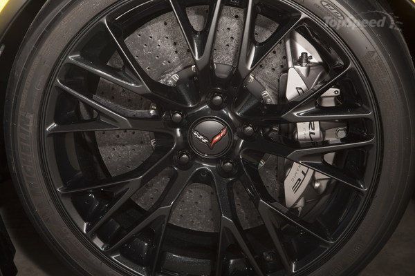

Doing some research for my new wheels and thought I would share the difference between the Z06 and Stingray wheels and tires!
vs.
Front wheels:
C7 Base and Z51 front wheel (respectively)
18x8.5 ET 56mm
P245/40ZR18 (93Y) SL Michelin® Pilot® Super Sport® ZP
19x8.5 ET 56mm
P245/35ZR19 (89Y) SL Michelin® Pilot® Super Sport® ZP
vs.
C7 Z06 front wheel
19x10 ET 43mm Listed weight of 25.7lbs.
285/30ZR19 (87Y) SL Michelin® Pilot® Super Sport® ZP
Result:
  • Suspension clearance: Z06 wheel is 7 mm (0.3'') closer to suspension/brakes components. Acceptable for most cars.
  • Fenders clearance: Z06 front wheel will stick out 33 mm (1.3'') farther.
  • Wheelwells clearance: The same.
  • SPEEDOMETER: The same.
____________________________________________________________
Rear wheels:
C7 Base and Z51 rear wheel (respectively)
19x10 ET 79mm
P285/35ZR19 (99Y) SL Michelin® Pilot® Super Sport® ZP
20x10 ET 79mm
P285/30ZR20 (95Y) SL Michelin® Pilot® Super Sport® ZP
vs.
C7 Z06 wheel
20x12 ET 59mm Listed weight of 31.8lbs.
335/25ZR20 (87Y) SL Michelin® Pilot® Super Sport® ZP
Result:
  • Suspension clearance: Z06 wheel is 5 mm (0.2'') closer to suspension/brakes components. Acceptable for most cars.
  • Fenders clearance: Z06 wheel will stick out 45 mm (1.8'') farther.

415 Posts
Your rear wheels sizes for Base/Z06 are not matching the tire size such as 18" wheels with 19" tires. etc
Rear tires compare of base and Z06 :
Specification Sidewall Radius Diameter Circumference Revs/Mile Difference
Base 285/35-19 3.9in 13.4in 26.9in 84.4in 751 0.0%
Z06 345/20-19 2.7in 12.2in 24.4in 76.8in 825 -9.0% effects MPH, TC, Calculated MPG & distance
873 Posts
C7 Z06 wheel
345/25ZR20 (87Y) SL Michelin® Pilot® Super Sport ZP
The 2015 Order Guide lists the rear tires as 335/25ZR20

6 Posts
I want to install a stage 3 z06 splitter and z06 wheel well flares on my z51.
From I red above the Z06 front wheel sticks out 33mm past the z51 one.
So I will need a 1.25 spacer/adapter to bring my z51 front wheel flushed with the z06 fender flare ?
176 Posts
Will that work Elspa? Will it be flush?
Has anyone just gone wider tires on Z51 wheels?

176 Posts
So if I am reading this correctly the Z06 wheels will fit the just like the Z51 wheels with no modifications but the tires will stick out further as mentioned.
Is the amount that sticks out more than the edge of the fenders on a non Z06 C7?
