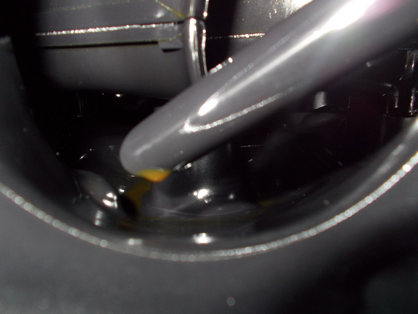

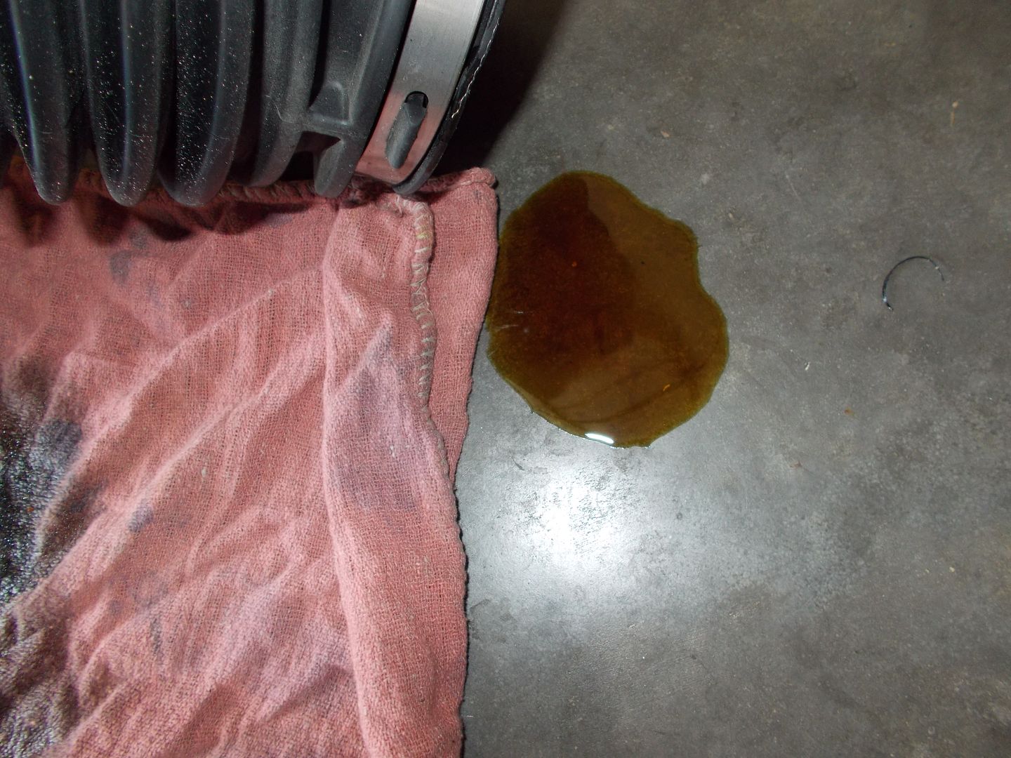

I took the air box of last week and checked it for oil. the box itself was clean and dry along with the filter and the intake. I turned the air box upside down and had a couple drops of oil come out of the well where the clean side hose connects. I reached in and stuffed a paper towel in twisting it around till I could no longer get anymore towel in. Pulled it out and there was some oil on the towel, not much. The well where the pcv hose attaches was clean. The car is at 6,000 miles and one oil change. The oil level is running center of the has marks since the change and that's at my 7 min. baseline. Prior to the oil change it was toward the upper end and I'm assuming at the oil change the new 9.5 fill was done.
Prior to taking the whole box out, I just pulled it loose at the engine side and looked down in the air box and into the intake, it was dry at that time. I wouldn't have noticed the oil in the well where the hose connects so I don't know if this was from earlier or a more recent event.

You could, but once it has made its way to accumulate in the sump depressions, plenty is already been flowing into the intake air-charge itself. GM has molded in sumps like this for years. The V6 DI engines have a deep sump just inside the IM snout and the snout angles down to collect oil. The explanation of capturing vapors for the EPA is stretched a bit....it is to collect oil (un-officially) as you see them do. And the last C7 in for a free install had almost nothing in the airbox/filter, but the IM itself was saturated and puddled with it.

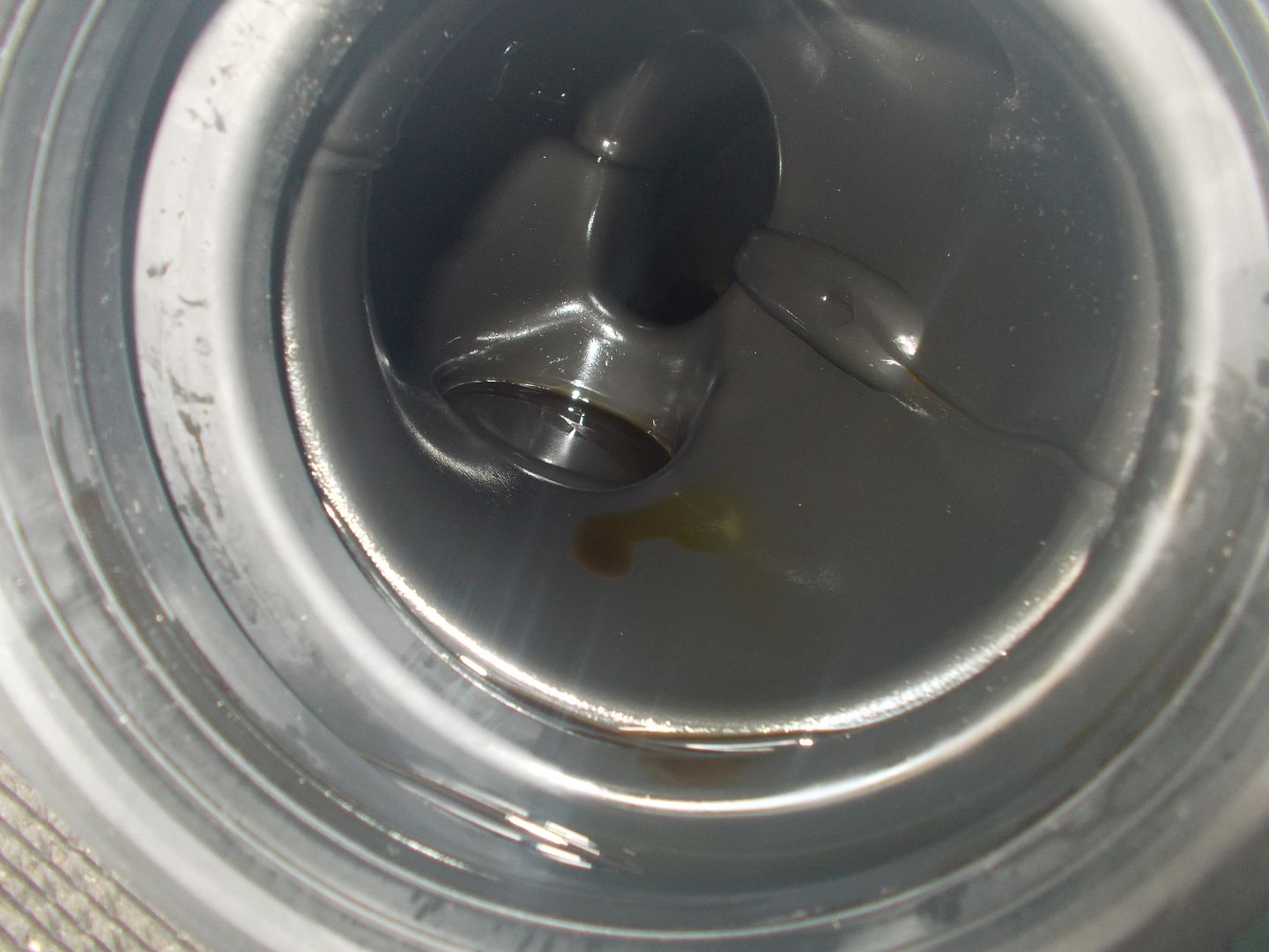

Letting everyone know that I've had the clean side sep on from elite since the car had 60 miles on it. Also have had the dual valve catch can on the same amount of time from them too. Noticed at 4000 miles that oil was comin out of drilled hole into coupler. Had dealer dismantle and everything was covered in oil. Filter, box, coupler.
They cleaned everything out and replaced filter, but this goes to show that if car came from factory overfilled (mine did, had oil change and at correct level at 3800 miles) that even with a clean side sep oil will burp out of your z51. I'm sure it would have been worse without the sep, but my experience should be proof and reason to get your oil level correct, and add the clean side sep.

You are correct. There is no way to stop an overfilled tank from forcing right through the cleanside unit.....take a quart of oil and pour it in and fill it up, it will come out the other end. When the oil level is correct, it traps those vapors that momentarily push backwards keeping the oil from entering the intake air charge.

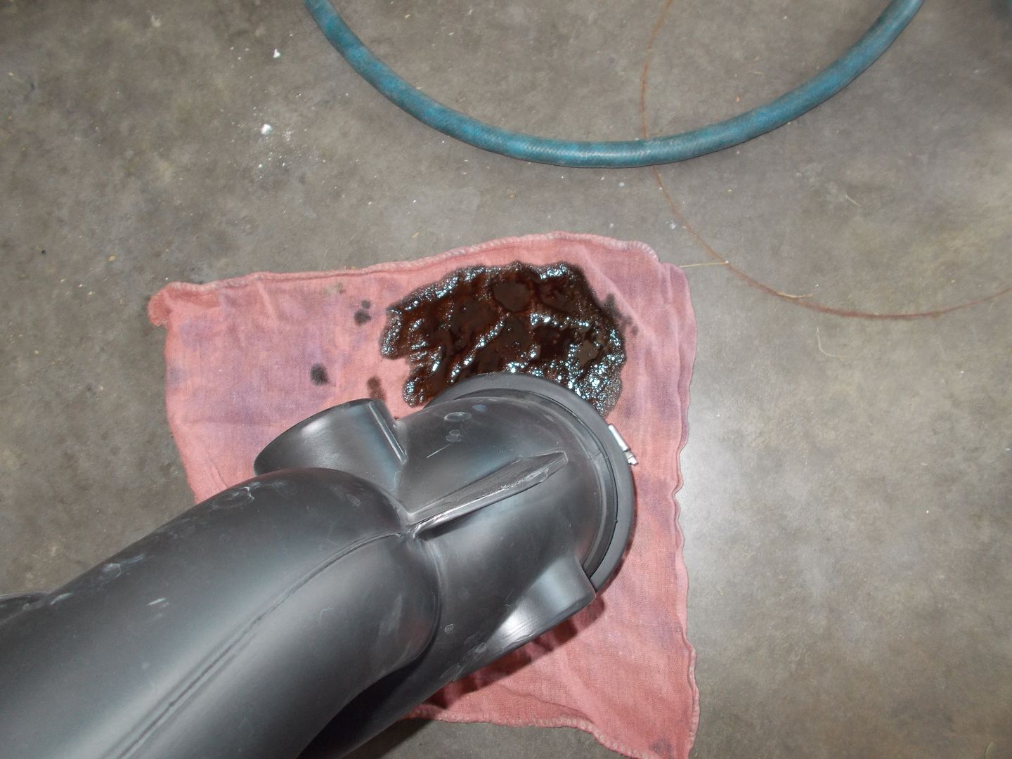

Just had a C7 in here Friday that we dumped a ton of oil out of...and his dipstick is on the bottom of the hash marks:

I can also confirm GM has molded this "catch basins" into the air boxes, and with the v6 DI engines, just inside the IM snout (which is angled down to assist oil collecting in them via gravity) as they have known very well about the oil issues with DI engines. In fact, the intake manifold on the GM 3.6: V6 even have a boss cast into them where a pet cock was tested early on allowing the techs to open and drain, but far to many got confused and accidently left them open instead of closed causing vacuum leaks that they abandoned it early on, but they are still there for 2015:
And these are wet sump engines, so the issue comes from the PCV system itself....no over filled oil sump:
You never want any oil entering, because if enough comes through to accumulate in the amounts your seeing, a ton more is ingested via the intake air charge directly into the combustion chamber as most remains suspended as a mist. So if your seeing ANY accumulation in the air box or the intake manifold, (and even the wet sump C7's we remove the IM we can dump oil out of all of them, wet or dry sump.
So a band-aid that you just wait until condensed oil is filling the molded in depressions, you have already ingested a ton into the combustion chambers. Any one that doubts any of this just take the few minutes to remove your intake manifold (tales 15-20 minutes with minimal tools) and tip it on its snout and watch the oil drain out. Then your right up close to your intake valves...shine a flash light in and see the level of coking and there will be no more debate (except the few truly ignorant that will believe the deposits as fine).
